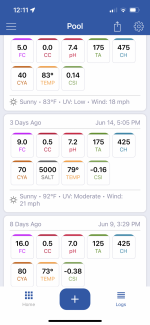

I read that high amounts of FC will drop CYA. We finally dropped FC to 5 and turned on the SWG. Our CYA is at 40. Pool math is showing I need to add 3.5 lbs CYA to get it to 80. I’m nervous about add that much at once, not wanting to go over. What is the best way to do this?
Add all at once
Half now and test in a couple days
Add sock at a time, retest every cpl days.
I bought a 16oz bottle of CYA testing chemicals so I’m not concerned about testing more often.
