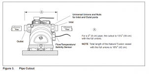

1) Whether the Nature2 and Aquapure would fit onto the same unions (footprint); and
2) Whether a replacement cable could ever help, given the uneven current I'm seeing.I would have thought that a cable issue would cause uneven current for both flow directions?

Amazing - thank you for knowing your way around their site so well!!
Can't decide which of these is most appropriate?
Either way, thanks!
