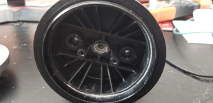

That would be great. I re-inspected the cell yesterday and it looks like the center terminal may be going out. There is some sort of insulator / shrink wrap material on it that looks like it's seen better days (photo below). Power washed the cell using the hose again and put it back into service for now. No 120's since yesterday, but I'm guessing that won't last long.

Oh - I already took it apart last year after I had the same issue as you and got a new one under warranty no charge. Below is what I found when I took it apart.
This is the center plate and electrode. It was burned totally through. Note how the shorter piece goes into the longer piece. This is why I said you will not be able to tell it is corroded by feel.
Note on the last pic it looked perfectly fine right up until I took it apart.
Your cell is toast. Order a new one!
