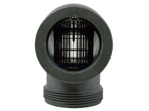

The way these cells typically fail is the center electrode corrodes through and eventually totally separates. They cannot be repaired even though the plates may have life left in them.

This is pretty much exactly how mine failed. One or more of the 3 leads on the cell are corroded almost completely through. They will seem totally solid until or if you take apart the cell to look. It is not serviceable, I am just pointing out that the cell is toast. It is not fixable.
