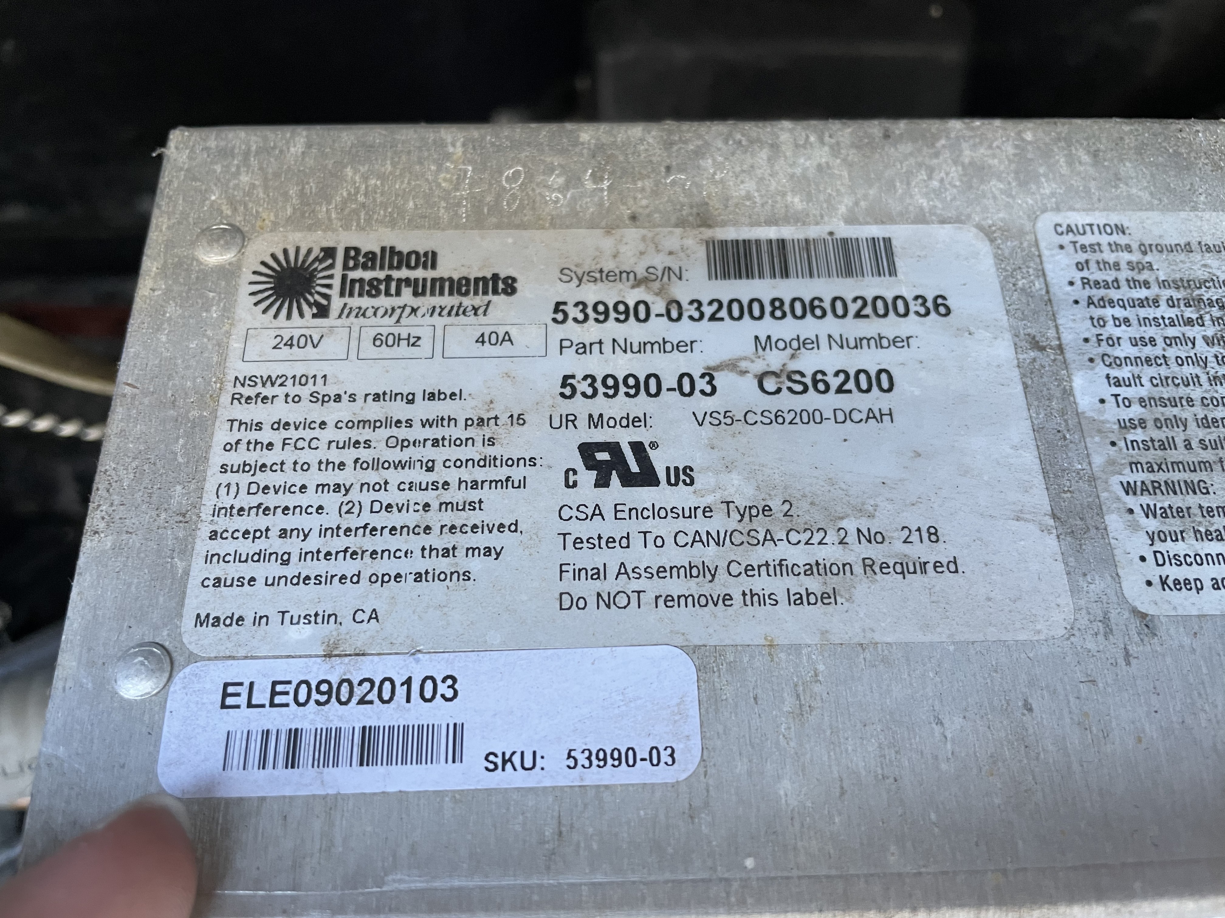

So after reading so many threads on spa breakers tripping it didn’t come as a huge shock when my wife informed me the hot tub was off and to turn it on so she could use it. Obviously I hadn’t turned it off, so I immediately headed downstairs where I saw the breaker had tripped. Tried a reset and as expected it immediately tripped. Since the tub is a 2008 I suspect like a lot of these I’ve read it’s likely the heater has reached the end of its life.
I’ll poke around at it some more when I have a chance, doing the typical troubleshooting items by disconnecting one thing at a time until I can re-engage the breaker without it tripping immediately. I’ll start with the heater.

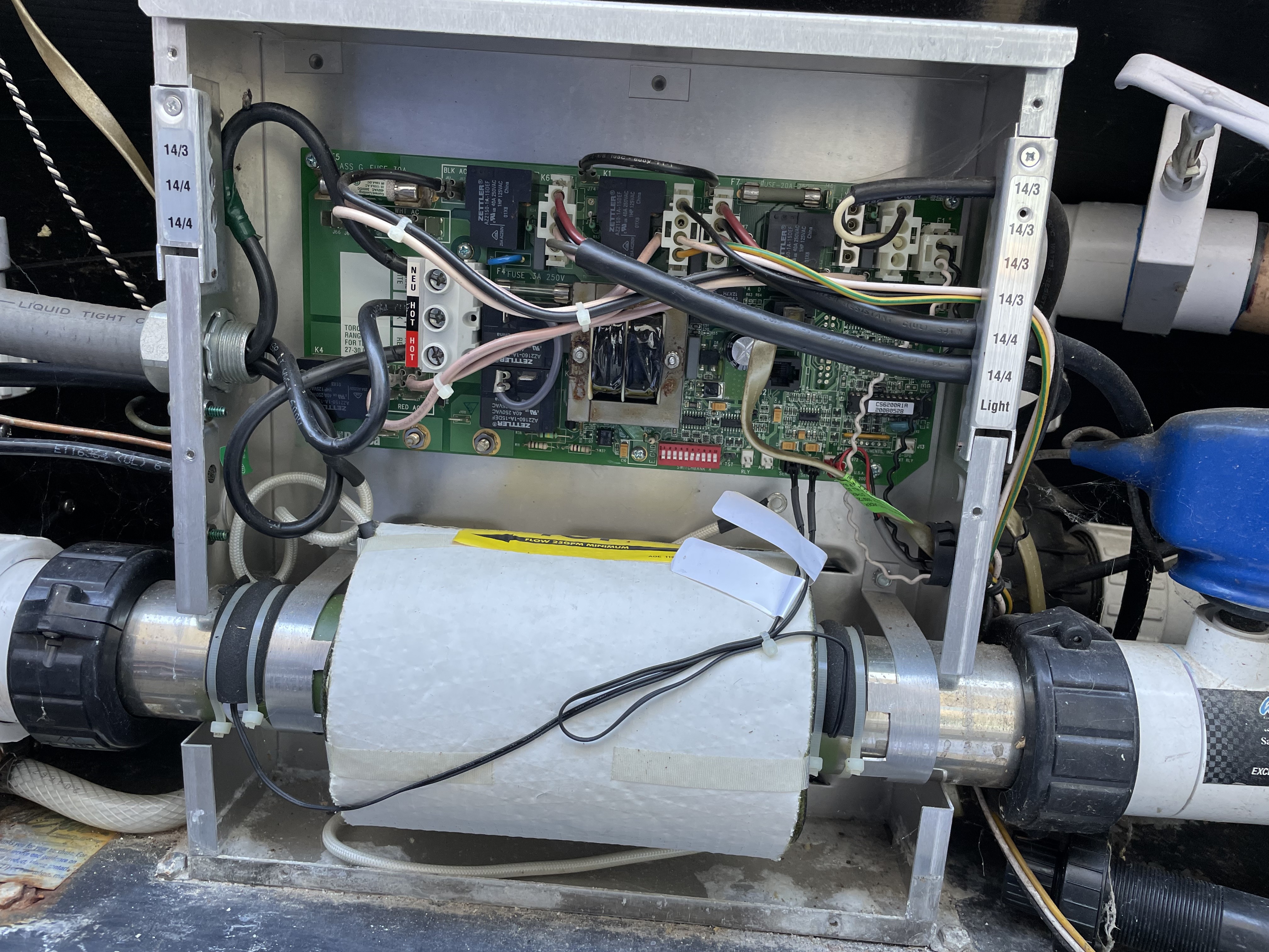

As expected, it was the heater. Disconnected the heater and turned on the power and spa started booting normally. Reconnected heater as a double check, turned on power and breaker immediately tripped again.
So now I need to find a replacement heater for this.

Update: Finally pulled the heater yesterday, and I’ve located a replacement heater for $130. I couldn’t pull off one of the fittings on the heater, I think it got glued in place when the fitting was glued in. So I need to order that too. But I plan to order parts today to get this back up and running.

Those cal spa "no-fault" heaters actually have the element wrapped around the outside of the heater tube under the insulation wrap. No physical contact with the water. It doesn't stop them from going bad, it just keeps it from being water chemistry related when it does. So, no inclony or titanium available.
Yeah but the SpaDepot replacement is not the same, it has a heater element in contact with the water. I'm unsure what the element is made of. Probably steel, as the replacement elements are $25. On the flipside, the replacement elements are only $25, so... 🤷‍♂️
