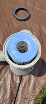

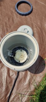

I have the 637R which has an air valve on top. The pump sits below the water level.
When I open the air valve, no water comes out of the top unless the pump is off.
Here are some pictures of the pump when on with the filter inserted and not inserted.
You can see the water at the very bottom of the pump, but it does not get much higher than that.

Kenny - what you describe sounds odd. Somehow your pump is getting starved. I have an Intex sand filter/pump, and it's sometimes hard to get it primed, but when its operating correctly, your pump should be full with water. The fact that it DOES fill up when OFF tells me your inlets are open and the pump is below the water level.
I guess the only advise I have is to check for any restrictions in the return line? And perhaps if there's a leak somewhere on the suction side?

This sounds normal. Pumps are not made to operate with the pump chamber open. SOP for pumps is with the pump hooked up but before turning on, open the air valve on the top of the pump basket until water comes out, then close the air valve. Now turn on the pump.
Most filters (including my Intex sand filter) have clear pump lids and you can see that with the lid closed, the pump basket is completely full.

Those pool pumps are not designed to take the lid off of them while they are running. Those small pump filters are just big enough to push water back into the pool while using gravity to pull water down to the pump from the suction side. When it is running and you have good flow to the pool, it is working as intended. The only time to take lid off is to take out filter to clean or replace.
