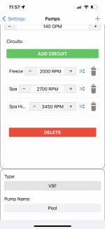

Hello - we initially had an easy touch system when it was a shared system. When we decided to separate, they changed it out to the intellicenter in order to have two separate bodies of water controlled by the automation. They did get the appropriate daughter card, so they really are two systems that can run simultaneously. The pump speed for the spa pump is set as a minimum of 1700 rpm so I don't know why it isn't running at that speed while in freeze mode. Looking at the new intellicenter2 app (post update from this week), there is an option to add a circuit under the pump settings, and two of the naming options are "Freeze". I am wondering if I should add that circuit to my spa pump and set the speed at 1700rpm?

That circuit named freeze is a virtual circuit, meaning it is not controlled by anything but the internal programming of the card when it detects a freeze condition. You may use that as a speed for the pump but I suspect that you simply do not have the Freeze checkbox checked on the spa body circuit. This will be under the configuration menu on the app --> Settings --> Circuits. All circuits that should be engaged during a freeze event will have the Freeze checkbox checked.

Thank you, but I have confirmed that freeze protection is enabled on both the spa circuit and the pool circuit. They both say “freeze protection” when temps drop. The issue is that the spa pump indicator light is on but the pump speed says 0 and isn’t on when I check it visually.

Ok. I will see what happens tonight now that I added that freeze circuit. Fingers crossed it works.
