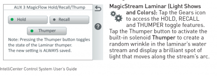

I am trying to program the intellicenter and magic stream laminars.
I can get the lights to come on. However can not find the screen to activate the intellivalve nor the “thumper” part of the magic stream. Still learning the intellicenter.

You will not find the thumper function in the Web App or Mobile App. It is only available in the Wireless Controller, Indoor Controller, and at the Outdoor Control Panel. If you have a valve that is part of the Laminar functionality go to the Valves configuration and assign it to your laminar circuit.

Rj & AJW - thanks for the update. I am driving myself crazy with that page, because it says that on pp14 but it’s not there on the screen.
I’m am at the outdoor control panel. Looking at the gear button. Hold and recall are there. No thumper.
Why in the world would it not be in the gear menu.

I only see the thumper functionality on the outside control panel. It is not in the mobile app or web app. I configured my MagicStream Laminars to Circuit Type “MagicStream”.
