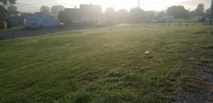

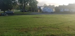

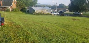

So here I am thinking I need to decide what I want to do placement wise. I'm thinking i want the pool pushed all the way down closets to the road. I have the Thuja green Giants and my fence will be 4ft on the inside of the trees. So I am thinking, I'll go 12ft from the fence, have enough room to plant along the inside of the fence for landscaping, then 4ft of decking and slide, and then pool. I would have them line the pool up with the road instead of the driveway. Then that will give me more room for decking on the other long side of the pool closest to the house. The afternoon sun would then be at out backs n not blinding us in the evening.
Also... pump placement. I was going to have it on the inside of the fence but I'm not so sure I want it that close to the pool? I was thinking about putting it right outside of the garage. It would be higher than the pool. Any issues with this head loss wise or for priming purposes? I'm not completely opposed to shoving it in the corner of the property closest to the shallow end tanning ledge (I had to flip the pool). Will it be easier for me to access closest to the pool when cleaning? I dont want to have to go through the gate to the pump n back through gate to pool n so on... should I keep it closer to the pool? I f I do, I have some ideas going through my head on hiding it and still keeping it open for airflow.
I need to know what you would do and would be easiest for me to deal with the equipment and pool maintenance wise whether its cleaning, closing, opening ect.... pics of yard from ground level.

Pool builder wants to put the pool closest to the driveway. Please give me your opinions. I only get to do this one time!!!
How much higher then the pool would the pump be? A foot or two, no problem. Over 5 feet can become a priming problem.

With a VS pump your only placement concern is looking at it. You have to be standing over it to hear it, and even then it’s barely humming at all. When showing my house to sell it we’d be standing by the pool and I’d point out the returns running. Then I’d have them turn around and see the pump that was running 15 ft behind them that they couldn’t hear.
IIRC, your property was flat/level enough that location shouldn’t be a problem for priming but confirm with Allen’s suggestion that it’s only a foot or two different.
