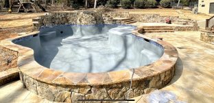

yes, we are are sooo close to completion......his goal is to dry out the ground where the decking will be installed....he will escavate some more of the dirt/clay and he said will lay down 8-10" of ABC base, thicker than he normally does he said....I'm assuming hes drying out the pool generally and the goal is plaster. For base prep the natural displacement of sub surface water by the drains is sufficient if they work properly
As for my pool I have a vinyl liner not a plaster pool. My water table is very high in a heavy rain my liner would float if I didn't have water evacuation. My pumps are set high up but can be dropped below pool bottom depth if needed. I have 2 full perimeter drains, one to pump pits that's deep, one natural pitch at the shallow floor depth. Basically you shouldnt build a pool where mine is, unless you got lotsa cash or build pools
My Q I keep ask he is - yes I understand we are pulling the water out of the ground and drying it out and yes I assume by doing so will allow for a thick sublease to be installed and compacted....but what happens after the fact and pump is removed and water table rises - - - he doesn't seem concerned .....I know the base will will be solid, but what about underneath it
Once we get that done, hoping this week, although there are a few days of rain in the schedule - then its just final grade and pebble sheen
