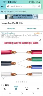

I saw a few old threads on the Intellichlor flow light staying red and so I apologize for starting a new one. In short, we just had the pool opened (we use a company to open and close the pool and I do the servicing in season) and the flow switch on our IC-20 is red though there is plenty of flow. I tried turning the pump speed up to 3200 RPM and it makes no difference. We are a few months out of warranty on the IC-20 (opening our pool for the third season) and I contacted the pool company that had opened the pool for us. He suggested cleaning the filter, so I did, and no luck. Then he suggested the flow sensor may be an issue and so I ordered a new one on Amazon and installed it tonight. Still red light. At this point, any suggestions anyone has on what I do next before giving up and buying a new salt cell? Really frustrating to be doing this a mere 2 seasons after installing the pool.

I am not conversant in using a four wire old flow switch with the new three wire IC. The black wire is common, so your picture assumes the green and blue are the common. I have never seen a flow switch with a blue wire.
Be sure the connections are secure. Tiny wires so can be an issue to get a good connection.
