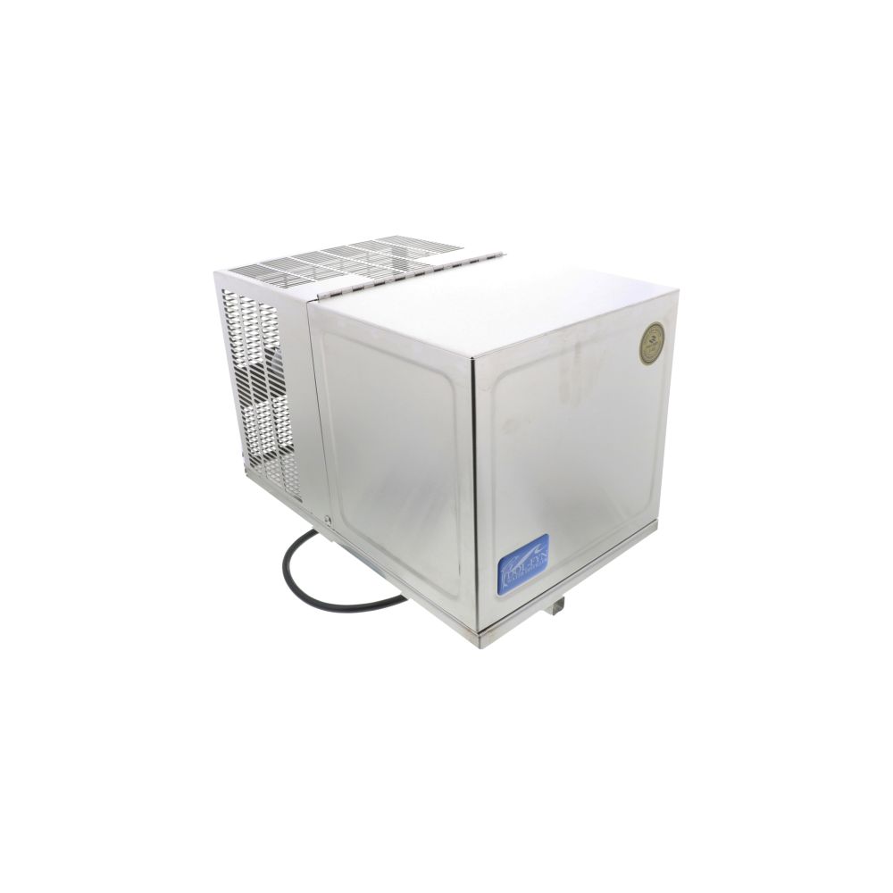

$1400 gets you a 9 gallon/day distiller -
You would probably want to buy the 12 gallon reservoir that goes with it as well as the cartridge filter and granular activated carbon filter on the output. Distillation typically requires filtration to remove contaminants that have vaporization temperatures close to that of water.

Personally I think it would be much easier and more feasible to figure out how to run a dehumidifier for a few hours a day. Even at 50% humidity mine will produce 2 gallons in a few hours.
JoyfulNoise
Platinum Supporter
May 23, 2015
17,626
Tucson, AZ
16000
Pentair Intellichlor IC-40
Just get one of these -
