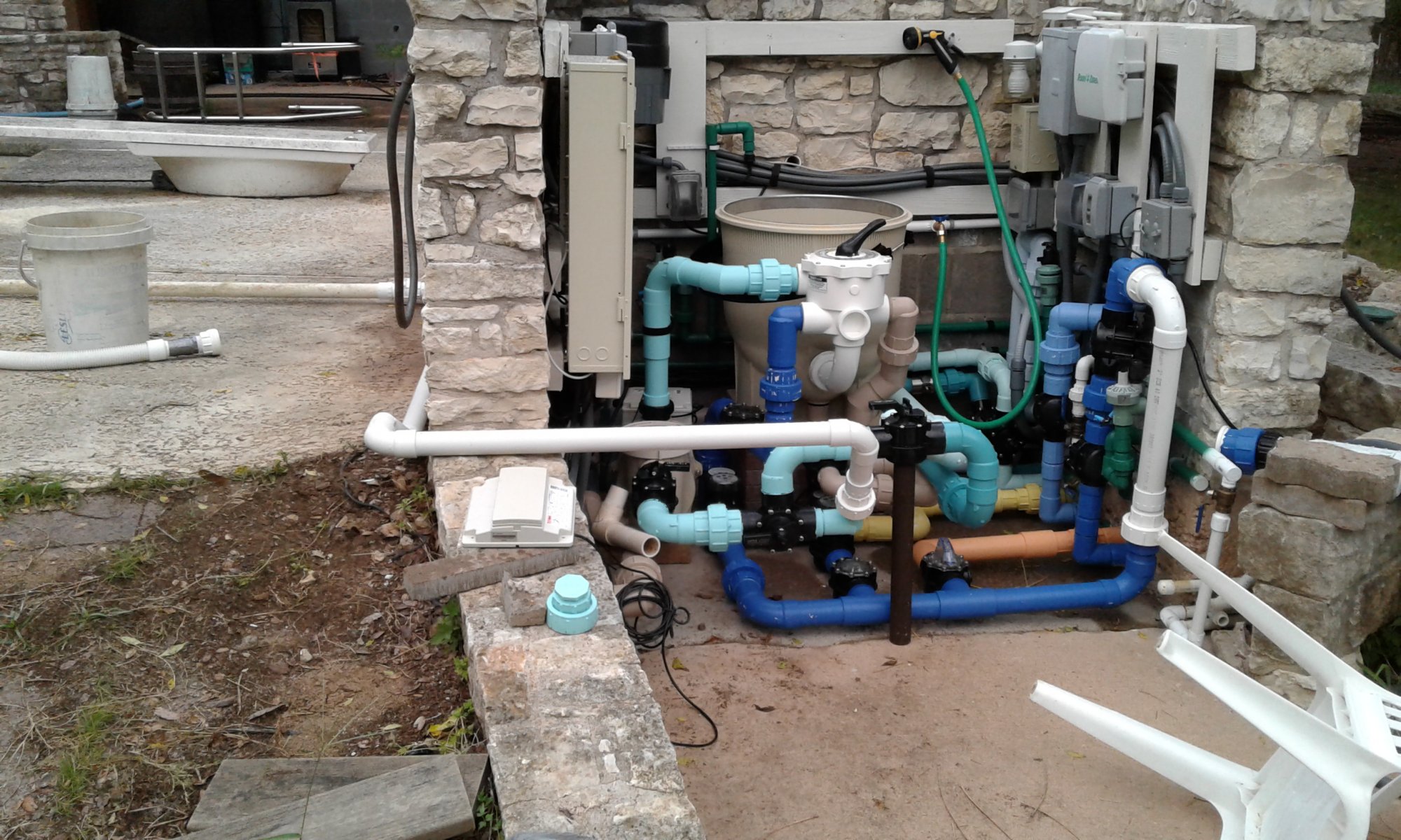

Thanks for responding! And I have thought about a potential pinched pipe…. I guess it could happen on the return side, but I would think that a pinch would more commonly be seen on the suction side…. For some reason only the vacuum and return lines were plumed flexible. The skimmer and main drain on the left were plumbed rigid. The waterfall line (where you see the flexible running up the back) was done rigid, but like what’s happening now, the rigid line got a crack in it, so we simply ran a flexible line up the back (to avoid having to demo the waterfall)….
I honestly don’t know how big the leak is, because I can’t get to it. As you can see in the pics, the ability to get in there is almost impossible as it runs under the slab of the 5 foot solid concrete waterfall….
Just out of curiosity, as you can see, there’s hardly any space along the edge of the pool and the fence, so would you suspect all of my pipes run under the waterfall and under the pool and simply branch up into each of the return lines?

My guess is that when the pool was constructed the PB did the shell and left the returns to the waterfall guy. I don’t know if it’s the best practice, but waterfall guys use flex. The rocks are actual bubbles with rebar to form the the shape and they use chicken wire and burlap underneath and spray Shotcrete and texture. So the rocks are actually hollow. It’s probably easier to maneuver flex around all the rebar to get to its destination. I have a feeling that maybe one of the returns kinked over time, causing a joint to leak. The returns would all be T off from main return.
To address the psi issue, is the psi 35 when you run the water fall?
Or only when returns are running?

First I must applaud you for all the pictures and videos and documentation. Truly is helpful.
So first off it looks like the pb did the returns based off the construction picture. You can see that returns, vac return skimmer and drain were all pressure tested prior to the waterfall being installed.
It’s Hard to say but it looks like the Returns being split may be under the footer for the waterfall and not actually in the bubble.
I do believe 3returns and vac return run along the fence line a foot under.
A pressure test I believe wouldn’t clarify a pinched line, only leaks present.
