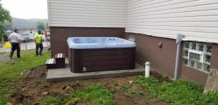

I just took ownership of my brand new Nordic Hot Tub yesterday. Its beautiful. I have read the owners manual and it said I will void my warranty if I use MA to drop pH or Liquid Chlorine to increase sanitizer levels. Do all hot tub manufacturers say this in their manuals? Should I only be using Dichlor? I'm going to be filling the tub today and going to the pool store for if I need to. I have CYA, MA, Chlorine, Baking Soda and Borax here already. I'll order some Ahhhsome here in a minute. Just looking for anything I should need to know from seasoned tubbers before I start.
Let’s get @RDspaguy thoughts.

If u only use dichlor you will max out cya in short order.
Don’t forget to add your new beauty to your signature 😊
That's what I was thinking. I really dont understand why they don't want someone using it. It's not like you'd be dumping it in willy nilly. Itd have to be carefully measured since it's such a small body of water.
