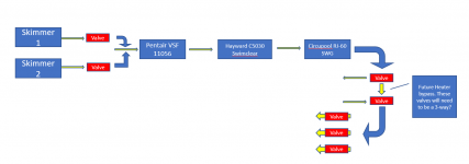

I am about to order my valves but wanted to see if anyone had any feedback on my plumbing plan?
5 - 2 way valves
2 - 3 way valves
Am I missing anything?

I would use a 3way for the 2 skimmers, with 2 valves you could deadhead the pump. I would just leave room on the pad and install heater later with valves. It's hard to anticipate the plumbing with it not there, and different heaters plumb various ways. With a SWG and modern heater with 2" headers I dont bother with bypasses. The flow restriction is almost non existent. Is your only suction the 2 skimmers? I see 3 return lines, how many actual return fittings?
