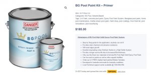

I have just completed grinding out osmosis and black spots and on the very last osmosis bubble I ground too deep and now have a hole in the floor of the pool shell about 2cm x 3cm in the shell. Can I repaid this myself with a kit they sell at the hardware store, then a coating of megapoxy or would it be a specialist job. I have attached photos of:
  • Osmosis & black spots ground
  • Hole in bottom of pool and a side one that has a black line
  • Fibreglass kits
  • Megapoxy
  • Paint
  • Paint primer
Any advice or information would be much appreciated, as the wife is not happy with me, due to the problem.
