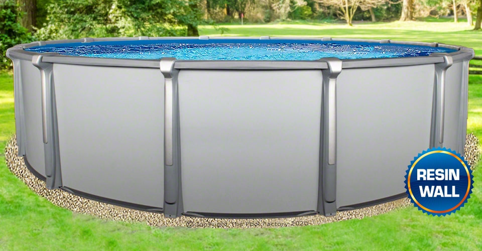

I liked that Aurora pool, I looked at it. But it is twice as much money. And the Saltwater 8000 is "saltwater friendly" and has a 60 year warranty, even if you do sink it in the ground up to 27". We are not completely burying it, only a couple feet into the ground.

The Edge, Core, and RJ a great models so far.. I have not heard anything bad about them.. You say the 45 is overkill but really it is not, the bigger the better as I also do not think the 60 is overkill... When they are bigger you can turn them way down and run 24/7 or turn them up to 100% and run them 2 to 6 hours and then turn your pump and system off... Just depends on what pump you have...
As for warranties, the Aurora is lifetime no questions asked replacement with no money... The 8000 is really a 10 year warranty and at 10 years you are paying 80% of the pool so really you are buying another brand new pool not to mention tearing out the old pool and reinstalling... The aurora will outlast you :)
I do understand the added expense though....

Ahh.... yes, I see what you mean. I just went and looked at the actual warranty documents, and it seems that 60 year warranty doesnt really mean 60 years. And, it really is only 3 year warranty, they you pay an increasing percentage of repair costs each year after 3 years. Maybe I will still have to consider the Aurora, even though it is twice as much.

So, I have decided to go ahead and buy the aurora, probably 27’ round. When is The best time to buy? Does the pool factory have sales during the winter time?

Okay, here is where I am at now. I decided that I am going to buy the Aurora pool, but we are going to stick with the same size we have now - 24' round. I have not ordered it yet. They are having a 20% off sale right now, but they extend the sale every time it is supposed to be over, lol.
