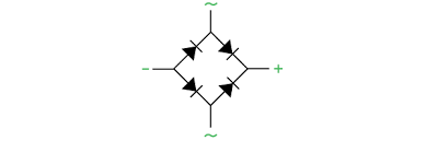

Bridge rectifiers are symmetrical so it shouldn't matter which AC lug you use. Of course it does matter which DC wires go on each lug but if they were swapped on one rectifier and not the other, the fuse would have blown. In that unit they use two bridge rectifiers to split the current so the heat generated is a little less but each is only using half the bridge.
More than likely it is the K1 relay or solder joint. A cold solder has higher resistance so the current would drop and the salt would read lower.
