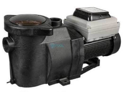

Hello, I am looking to buy a new pump for my 24/52 abg pool. At this time I do not have the pump or filter hooked up since each were leaking. When I did have it hooked up my utilty bill doubled therefore looking in to the 2 speed or vs pump. From what I gather vs are more expensive than the 2 speed and work a little different, but the 2 speeds will be energy efficient as well. I learned this information from reading you guys forums. I will try to keep the sand filter I currently have but will need to find a casket piece to go around the top, which I havent had much luck. (Its a 22 sand RX Clear with medial balls). The pool pump Im looking at is Hayward Power Flo Matrix , 2 speed, 115v 1.5 hp. I found it a Dohneys, I also see that Amazon has it for the same price. My question is on Amazon's site it gives two different Hayward pumps W3SP15932S for $409.00 and SP15932S for $610.00, both list as the same description. Im just learning about the pros of the dual speeds so I am most likely over looking what makes it more expensive. Do you recommend either of these and could you explain the difference and what makes one more more expensive that the other one?

I did go look at the calimar equipment and found one (I added link below) for $389.00, its the Calimar VSpeed 1.5 HP. All the others were around 700 and above. Is Calimar a good brand and why such that price difference concerns me.
