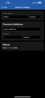

I added one gallon of liquid stabilizer yesterday, but the cyanuric acid (CYA) level is still so low that the test is unable to detect it. Before adding the CYA, the water was clear even at the 30 mark. Now, after adding one gallon, it is showing a little murkiness at 30. Any idea what could be causing this? I was aiming for a level of 45, but I should have at least reached 30.
PoolMath
1 gallon of liquid stabilizer will only raise 19,000 gallons by 19.

I did that there was nothing remaining in the bottle. Once I was done there was some sediment on the pool floor which I brushed off and it got dissolved. I have got 4lb of dry stabilizer now which I am going to add in 2 shots but I am concerned what happened? To 1st whole gallon.
Like I mentioned earlier, 1 gallon would only increase your pool's CYA by 19 ppm. The lowest CYA you can really measure is 30 ppm. The 4 pounds of dry CYA you now have should raise it an additional 25 ppm.
Reactions: sha56
That is helpful information, since I was not able to test for actual level below 30 I did put 20 as base level and then pool math told me to add a gallon and quart to reach 45. Maybe I didn't had even 20. Now I will add 4lb dry one and retest. Thanks a ton for educating me
