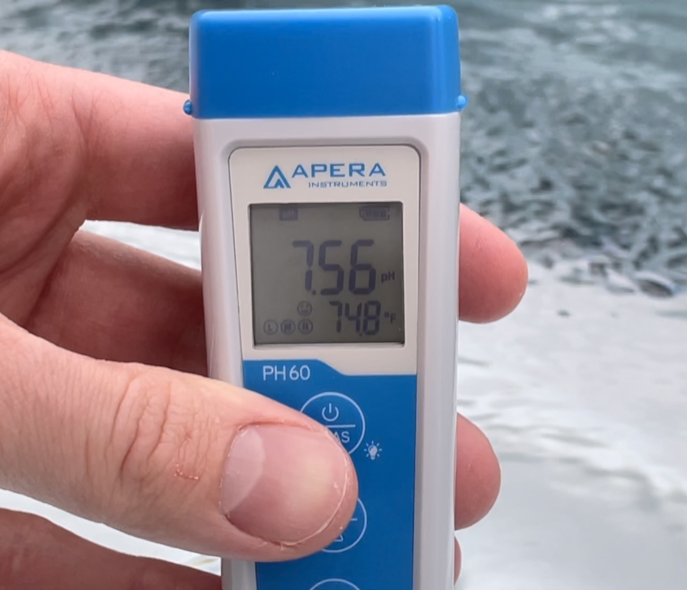

I have a video if people are curious but after call I went to the hot tub, turned on the meter and stuck it in. In 11 seconds I got the smiley face that indicates things are fairly stable, with a reading of 7.56. Note the temp was 75, this does have temp compensation but after about a minute it was up to only 85 (spa is 100) and the reading had only dropped to 7.55 (it had gone up to 7.57 shortly after this picture was taken, then slowly started dropping as the measured temp increased). In any case letting it sit until fully warm doesn’t appear it’s worth the time, with a close enough for pool usage reading in under 15 seconds.

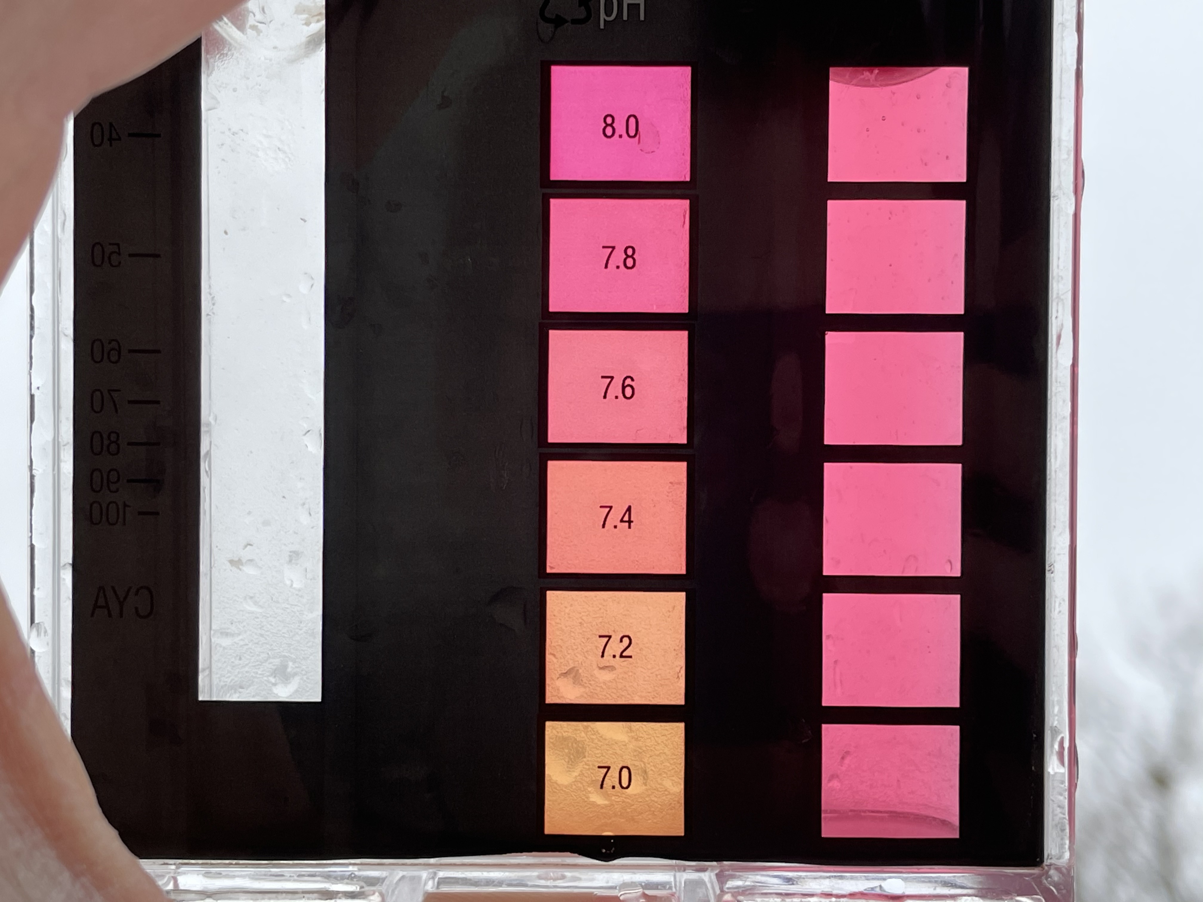

I then compared to my drop based kit. I had a bottle that was almost used up, with a reading of 7.7
And I had a brand new bottle of R-0004, which got me a reading of 7.5. Not sure why the difference, I didn’t think the old bottle was that old. I’ll have to check my purchase history and see now.
Conclusions from initial testing: Calibration is fairly easy, readings are quick for pool usage. Probably not something I’d like to have to maintain though if all I was using it for was pool testing.
