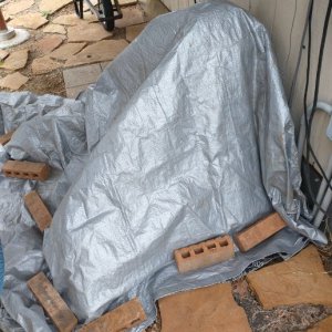

How's it going, I am preparing for what's supposed to be freezing temps this weekend in Houston. I wrapped the pipes around my equipment with insulation tubing as best as I could. Also covered the pipes with moving blankets and a tarp. My plan is to run the pump 24/7 beginning Thursday 12/22 through the weekend, and hoping we don't lose power. If power is lost I will empty the filter by opening the air valve. I also read I am supposed to empty the pump. How exactly is the pump emptied?

The freeze protection should run any pumps. I have mine set to run my filter pump which switches between the pool and spa. My waterfalls (second pump) run constantly as well.
I plan to tarp the whole equipment area and put two drop lights under the tarp. I have a huge equipment pad, so I'll put one drop light on each end. I will put the robot vacuum in the garage as well.
