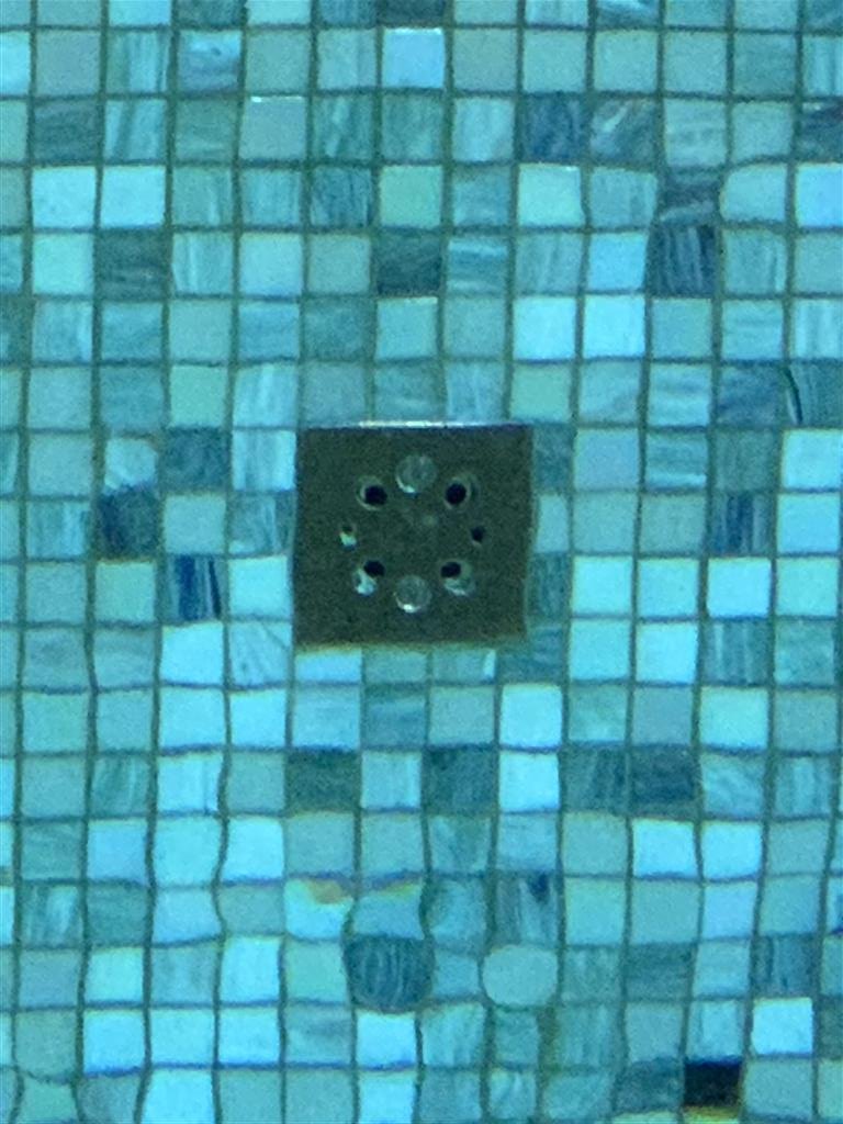

ajw22
Jul 21, 2013
20,474
Northern NJ
Below is the pool on the 5th floor of the Waldorf Astoria in Berlin, Germany. It is one of the most beautiful indoor pools I have been in. It has no skimmer and floor returns. I see no reason why you can't use floor returns.
