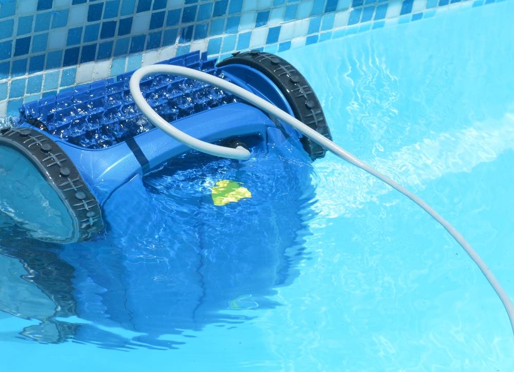

Chlorine and chemicals shouldn't be a problem. Your other suggestions I will take. The Kontiki cleaner is a suction type, link is here.
Is there a better type? I'm trying to make overall pool maintenance as easy and fool-proof as possible. Knowing me, I'll be anal and obsessed with testing, checking, cleaning, etc, and never get anything else done around the house. I'm like that until I get into it and probably realize it isn't as bad as I imagine now.

Here's some information on cleaners-
A robot is the best, but they are expensive. An automatic suction side cleaner like this can work, but keep in mind that in an AGP your skimmer is your only suction source, so if you have the vac hooked up to that then you are not skimming whenever you have the vacuum hooked up. You can only do one at a time.
For me, I just use a combination of a manual vac (hooked up to the skimmer/suction like the automatic one is), and a cordless vac (the 'Pool Blaster Max HD'). I'd love a robot, I just can't justify the cost with how short our swim season is. I probably vacuum maybe 10 times over the summer.

I have had a variety of suction side cleaners - Zodiac models, as well as a number of Waterbugs. Not worth the effort in my opinion. I found them to be extremely finicky. The suction had to be just right or else they stopped moving or climbed the walls. With a suction side cleaner it was take the thing out, set it up, mess around with it for 20 minutes, get it working, come back 2 hours later to find it somehow tied itself into a knot or decided to stop moving, take an other 20 min to fix it, come back 2 more hours later to find it done, but it still missed in the corners around my stairs. OR hook up the manual vacuum and take 30 min to vacuum my pool. (I still have a Zodiac Wahoo and 2 Aquabugs in the shed, I have not had the urge to use them for 2 seasons now - I'm not a masochist)
