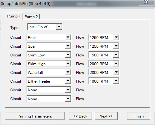

The Standard EasyTouch has two user programmable valve drivers.. It comes with 4 drivers, but two have fixed programming that are only used to switch between the Pool mode and the Spa mode. You do not normally use the High voltage relays to control valves.. (You can, but you just waste a relay).. You can control valves with something called a "Feature Circuit".. You can turn a feature circuit on/off from the main panel or any remote or ScreenLogic or you can just schedule it..
One of the great things is that you can tie the feature circuit together with a pump speed.. So, when you turn on the feature, the water will flow and the pump will run at whatever speed that you think looks the best...
You don't need automated valves to for your skimmers or main drain.. But you do want the ability to manually determine how much suction goes to each one.. You do that with a series of Jandy style valves...
You can see by this pic that when I turn my Waterfall on, the pump increases speed up to 2800 RPM..
