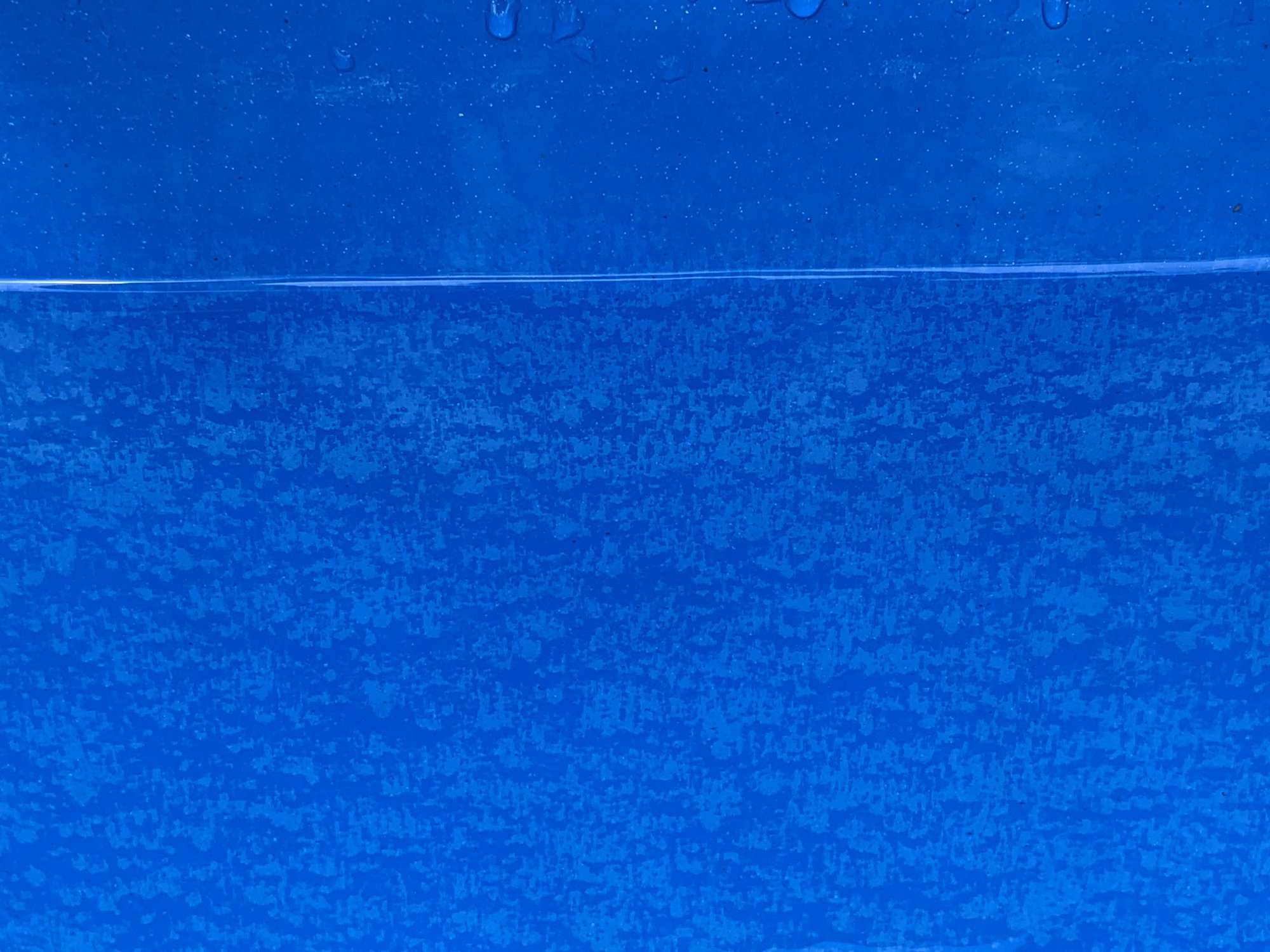

Hi all,
The walls of my 3-year-old fiberglass pool have a texture under the waterline compared to the smooth texture above the waterline. It's not like sandpaper grit or chalkiness but there's a definite texture that doesn't belong there and wasn't there for the first couple years. There is no change after vigorous brushing and scrubbing so not sure if it's a residue/scale that has built up or if it's some kind of erosion or pitting of the gel coat. I have been brushing ~weekly.

I've read though some of the other threads here relating to fiberglass pool shell problems but haven't found anything that sounds specifically like my problem. I don't see any visible sign of what I feel and I can't scrape off any residue. That said, I gather the most likely explanation is some kind of scale, but how do I test for scale below the water line? Are there any other tests I can do to investigate the cause?

Thanks Texas, I will try that. I can't feel the abnormal texture on the horizontal surfaces of the steps or floor because they are textured themselves, but I will try adding acid to the wall above the first step. With the heat this week it shouldn't take long to drop the level!
I do not notice any change in color.

To test for scale, Viking had me lower the water level to expose the first step and pour muriatic acid on it to see if it reacted (fizzle). Besides the change in feel, has the color changed at all?
Lets say that OP lowers level and it does NOT fizzle. This would rule out calcium scale I would assume. Are there any other likely causes for roughness on the walls?
With no color change, I can only assume the gelcoat itself has changed/adapted for some reason due to effects of being underwater. Might be something the OP discusses with the manufacture.

Update... I dropped my water a few inches and added muriatic acid down the side of the wall and didn't see any bubbling reaction or any difference in the texture afterwards. I also took my water to a pool store for testing on the off chance that what I'm feeling is metal staining but iron and copper were both zero. Other results were close to my own. The only surprise was my salt level is slightly high at 3602 ppm. I don't routinely test for salt and have just used the indicator on my SWG to let me know when it's in the appropriate range. I told the pool store manager my issue with the texture change and she took one look at my results and told me confidently that the issue is salt scale on the walls and to use stain and scale remover. I know calcium scale is common with SWG and FB pools but is there such a thing as salt (sodium chloride) scale? If so, wouldn't that be able to be scrubbed off with a brush? I suppose I'll try the stain and scale remover but I'm not super hopeful.
My current theory, in line with Texas Splash's comment above, is that something happened to the surface of the gelcoat during the winter. With all the cautioning from manufacturers to keep your water constantly balanced for the health of the pool surface, it doesn't make a lot of sense to me that the water can just sit there stagnant for 6 months over the winter with no testing or balancing, especially for alkalinity and ph. I certainly did not receive any guidance from my builder or even the manufacturer via the manual to do much of anything between closing and opening. My water at opening this year was very low in both alkalinity and ph and I'm concerned that has caused corrosion of the gelcoat. One of the main reasons I went with fiberglass over gunnite was the supposed durability and low maintenance aspect of FB, and if that is what ends up being a serious problem I'm going to be one unhappy customer to say the least.
