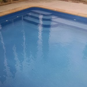

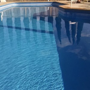

To kick this thread off, here are some photos to help illustrate my situation:
These photos are from Apr 2018, following about a year or more of maintaining a very low CSI, was during an acid test on the top step and illustrates the chalky effects below the waterline:
These photos are from 16 Jun 2018 after much sanding with standard water chemistry.

Here is an overall shot on a somewhat overcast day (lighting makes a big difference in the gelcoat's appearance.
A NEW TEST BEGINS! Today I did a quick sanding test strip (320 grit black wet/dry) just above the LED light.
Closer view. I will monitor this strip closely for the next year or two to see if anything I'm doing in my chemical management seems to influence change.
Deep end. Because of the sunlight and angle, it's a bit hard to see the changes.
Here you can definitely see the difference from my 2018 pre-sanding to how it looks today. Although I can tell some slight fading has returned on the darker blue, it is still holding-up fairly well and looks better than the areas I never touched (i.e. floor).
