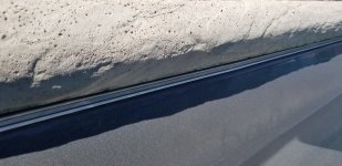

Casey, this is so pretty! What is your coping and surrounding made of?
I have formed concrete. Nothing special but great guys who know how to build pools and pour concrete. They put a white track down onto the fiberglass pool and snapped a form on it and the added a foam looking form that gives the appearance you see on the face of the "coping". When they laid the concrete, they vibrated it to pull out all the air pockets so it didn't look cratered with holes.
As far as your color choices go, get the pool finish that you want. You're only going to build this pool once. I had a tight budget and went with plain brushed concrete and I had a great experience with it. It has already started cracking where its supposed to at the control joints. I feel that I chose the best PB in the area.
