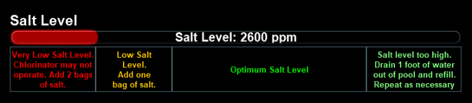

It appears I don't have a "CELL" light on, on the physical SWG out on the equipment pad.
My SWG and and ScreenLogic seem to think my Salt Level is 2600 (even tho my salt has been 3000 to 3400 since I turned it on). Is started at 3,400, and I'm now at 3,000.
If there are no lights on in the "CELL" section of the SWG, does that mean it is not on? The reason I ask , is that, even though my Salt level seems fine when I measure it with my Taylor Salt Kit (3,000), the SWG thinks the Salt is 2,600, and the CELL light is not on.
Or, perhaps is it just a bad unit that's broken?

I noticed that the cell light was on yesterday (Monday), but not today (Tuesday), and I noticed that my FC was much lower tonight than it was the last 2 nights, when I did my nightly test to try and fine tune it. I wonder if the SWG stopped running today. The last 3 FC tests (around 9pm every night) were Sunday 5.8, Monday 6.0, Tuesday 3.0, AND, Tuesday was much more overcast / cloudy for much of the day, and Sunday & Monday were bright and major warm and sunny.
Perhaps I just need to add some salt?

Update, it's 3:30am here, and I just added 60 pounds of pool salt and brushed the pool really good. I've read enough about SWG's here on TFP to know that often times the SWG might think the salt level is lower than it is, so I added more salt into the pool to see if somehow that gets the Cell light back on. Hopefully the SWG thinks it can run in the morning.
