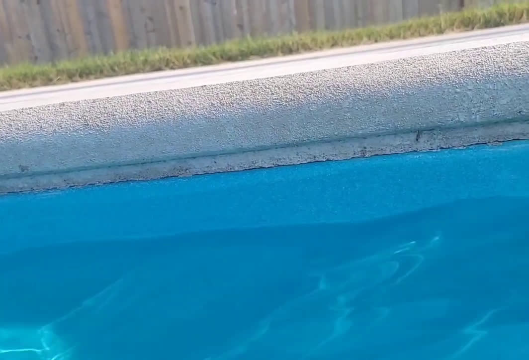

Just wanted to report back. I've just redone it with sikaflex polyurethane sealant and it looks pretty good. We'll see how long it lasts. This stuff is pretty sticky. I ended up draining a few inches of water and running painters tape all the way around before caulking. My only other long term concern is cleaning it over time but we'll see how it goes. At least there won't be any water getting under the coping. And one more thing to mention...before applying the sikaflex, I went with a small screwdriver and took out all grout that was a bit loose. So the grout I had left was the hard stuff that wasn't going anywhere. And then when I caulked, I caulked over everything, a continuous seal. I hope it was the right approach, only time will tell.
Reactions: Texas Splash

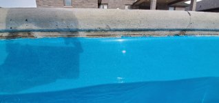

You. Here is my coping. Im hoping to have this fixed.
Since you don’t have a significant cantilever you may want to do a bit of research on a sealant with higher UV protection - the sika can yellow slightly if exposed to direct constant sunlight - also you might want to look into something that comes in grey to match your coping since nothing will be hiding it.

I am looking at possibly having glass tiles added. Not sure yet about what we will do.
