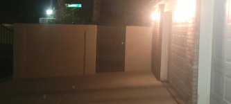

Just for reference, these are the only two entry points to the backyard.

Gates and doors shall be self-closing and self-latching and comply with 305.3.2
Shall be = MUST BE, in legal parlance. IANAL.
Both security doors have a single double deadbolt
Think you want a self-latching (not deadbolt), and permanently locked from the outside.
*Don't shoot the messenger*

That's impossible. They are always locked, but I open one of them on Saturday morning so the landscapers can gain entry. The same on Tuesday for the pool guy and every other Monday for pest control.
