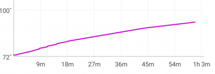

here is the test setup..
this is right when I put them out there.. 1 is no solar and 2 is solar.. the solar jumped 1 degree before I got a snapshot of the temp, they were both at 72...
this is number 1 no solar after 1 hour
This is solar after 1 hour

so if solar does not heat the water how did the water get 15 degrees hotter than the other water in bowl #1?

In your example, the Saran Wrap is not producing heat. It is preventing heat loss. The heat is coming from the sun, passing through the wrap, and then heating the water. The wrap is then retaining that heat allowing for cumulative heat gain.
Put the two containers in a dark closet. Over time, both will stabilize at room temperature, because there is no heat source.
