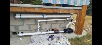

I knocked out the plumbing yesterday. Let me know if anything doesn't look right. I couldn't find sweeping elbows at lowes or HD so i used 45s and doubled up on the supply line from heater the heater to the jet manifold. The weird upside down pic is the plumbing for the topside air controll valve. I ordered jet inserts a few months ago and just realized after checking my emails that the order was cancelled and they never shipped. Hopefully i can pick some up at lesslies but i think its a long shot. Working on electrical next.

Looks good with 2 questions..
1. do you have enough room to get the top of the filter off?
2. why 2 pipes going to the same pipe? Those ball valves only last a couple years then the ears break off and need to be replaced...
Thanks for quick feedback! Yeah the filter is out far enough to get off with no issues. The two lines are my attempt to reduce pressure loss... really no other purpose. Yeah i read that about those valves. In a year or two i'll redo it with the correct valve and sweeps and eliminate one of those lines.

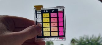

I filled the hot tub yesterday and today i need to deal with water chemistry. I am a dummy for not doing more research and practicing with the TF100 kit, so i think i meed some help getting started. The startup procedure for the plaster requires ph of 7.4 to 7.6 and alkalinity from 80 to 120. Here's what i have based on my testing this morning.
Ph 8.5 (estimate because its above the scale)
FC 0.5 to 1
TA 200
CYA 0? (The solution never went cloudy and obscured the black dot)
So thoughts and next steps? Are there other tests needed immediately to determine what to do next? I'm heading to the pool store when they open and will be reading up as much as possible between now and then. I assume i need to bring the ph down with acid as a first step?

So far I've used a little over a half gallon of 14.5 % MA and the pH is still high (TA down to 60). I plan to keep adding acid until the pH comes down, but is that the right move?
I'm not able to brush the plaster for the first 14 days so there's a lot of dust settled out on the bottom which are the lighter colored areas in the photo. Should I rig up a vacuum and suck it out or just leave it and deal with it when I'm able to brush?
