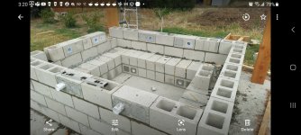

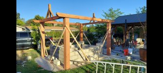

More progress today, although mostly on the pavilion. The lumber showed up yesterday and i couldnt wait to get started so i burned some PTO to work on this. Once the top beam and rafters go up i'll shift gears back to finishing the block work.

The lumber showed up, nice! I just go out in the woods and get my own, I got tired of paying lumber yard prices! Is that cedar?
No, it's redwood. The price of cedar right now is ridiculous. Good on you for milling your own, I'd love to be able to do that.

What mortar are you using for the block? I see your in CA I assume somewhere it doeant freeze? I would advise you to pin down some of that block to the slab and fill the voids to lock it. Just be careful with your block work, i can't use the stuff here except for a foundation. I always feel ita so much easier to make a form and use concrete, even if done in sections.

I'm using quikrete mortar mix and located in san diego county. Good idea on filling the voids. I might give that a try.

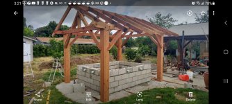

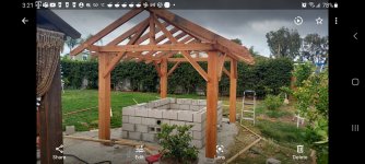

So i was able to get the pavilion as far as i can until i figure out what to use for the roof. One more row of blocks and i still need to install the overflow and skimmer.
