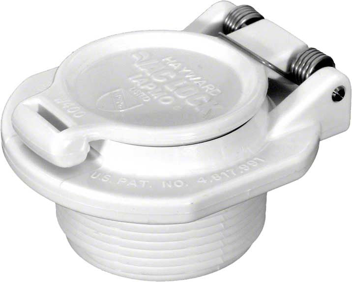

there is also a suction line on the west end for if I were to use a suction pool cleaner in the future. Will I need to plug this suction, or just use it as another pump return (do I need to put a screen over it or maybe a valve at equipment)?
The suction port will come with a plug of some kind. It's a safety requirement. Something like this:

Thank you @Rocket J Squirrel . That will be perfect.
