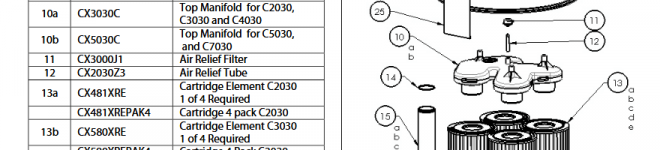

I will have to look at the diagram for the Hayward. Most filters have a screen at the top that protects the bleeder valve from debris. If that is gone, some can send dirty water out the returns. You do not see it except at startup after disturbing the filter as that is when the dirt is concentrated in the water left in the filter.

I could not find a 7020 on Haywards site. Their is a Swimclear 7030.
On the diagram, see the Air Relief Filter. Check to be sure you have that.

Then either your cartridges are not fully seating in the manifolds or there is a failure of the manifold system somewhere or a filter is damaged. There is not to be any dirty water getting to the clean side of the filters.
