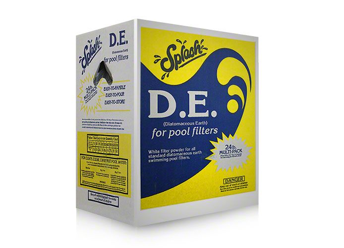

I have used this Big Splash DE Powder for years. I buy it locally for a lot less then this price. I like that it has individual 6 lb bags and I usually use one bag and the rest stays fresh and nothing blows around.
I would fill up a large bucket with tap water, add some of your DE, and see how well it dissolves.
