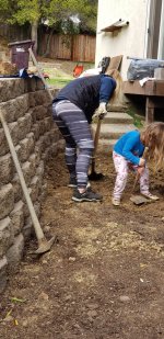

I'm the meantime we resumed prep work for the equipment pad pour... We will need few more hours. The location requires us to work completely by hand. I need to remove about 4-8" of soil, but we found that it's oddly relaxing after a week of office work. We are about half way done.

Well she makes everything take longer, she gets into potentially mildly dangerous situations, she most definitely does not make use of proper PPE, but I hope long term she develops a mind set of good work ethics. Surely digging by hand is miserable and tedious... so much respect for the professionals that do that every day.

Even if it does take longer it will pay off in the end it will so SO worth it..............the wanting to get it done faster is what keeps a lot of adults from allowing the little ones from doing the work thus instilling in them to let others do stuff for them.
