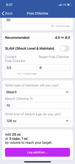

@Colleen0904 Checking your logs, I'm concerned about your chlorine. At a CYA of 50, you must never let it get below 4. Even Flirting with 4, and you are dancing with algae. CHECK OUT: FC/CYA Chart. You need to keep it between 6 & 8. I recommend just target and keep close to 8. You won't feel it or smell it. It will cause no damage. It will protect you from algae.
You should have added 53 oz. (half a gallon if you don't want to measure) when your FC was 1.5 today (Assuming you have 12.5% LC) You should get it to 8 and keep it there until you know how your pool consumes FC. You may want to test a couple times a day until you get a feel for it. How did you come up with 30 oz.?

Noooo the filter has been running nonstop during the whole process. It runs for 12 hrs, and then shuts off automatically. So we go back out every 12 hours and turn it back on.
I added enough chlorine, according to the pool math app, to get to 6 ppm FC, which is what the app said to do. I had the kids in the pool for about 30 mins before we took a dinner break. I’ll retest and see what the levels are. I was just following the recommendation on the app.
Well we learned today that your swimming consumed a bunch of chlorine and you got below 4 (1.5). You started at 6. If you keep at 8-9, you would only have gotten to 3.5 to 4. Also learned that you might want to add a bit before and after swimming so you NEVER get close to 4!
for now until you learn more, keep it 8-9, even 10 will not hurt. You can lower your target when you learn how your pool behaves.

Did you configure pool and volume in pool math. I configured your pool from your sig, I get different results.
look at jug and give me date code on bleach.
