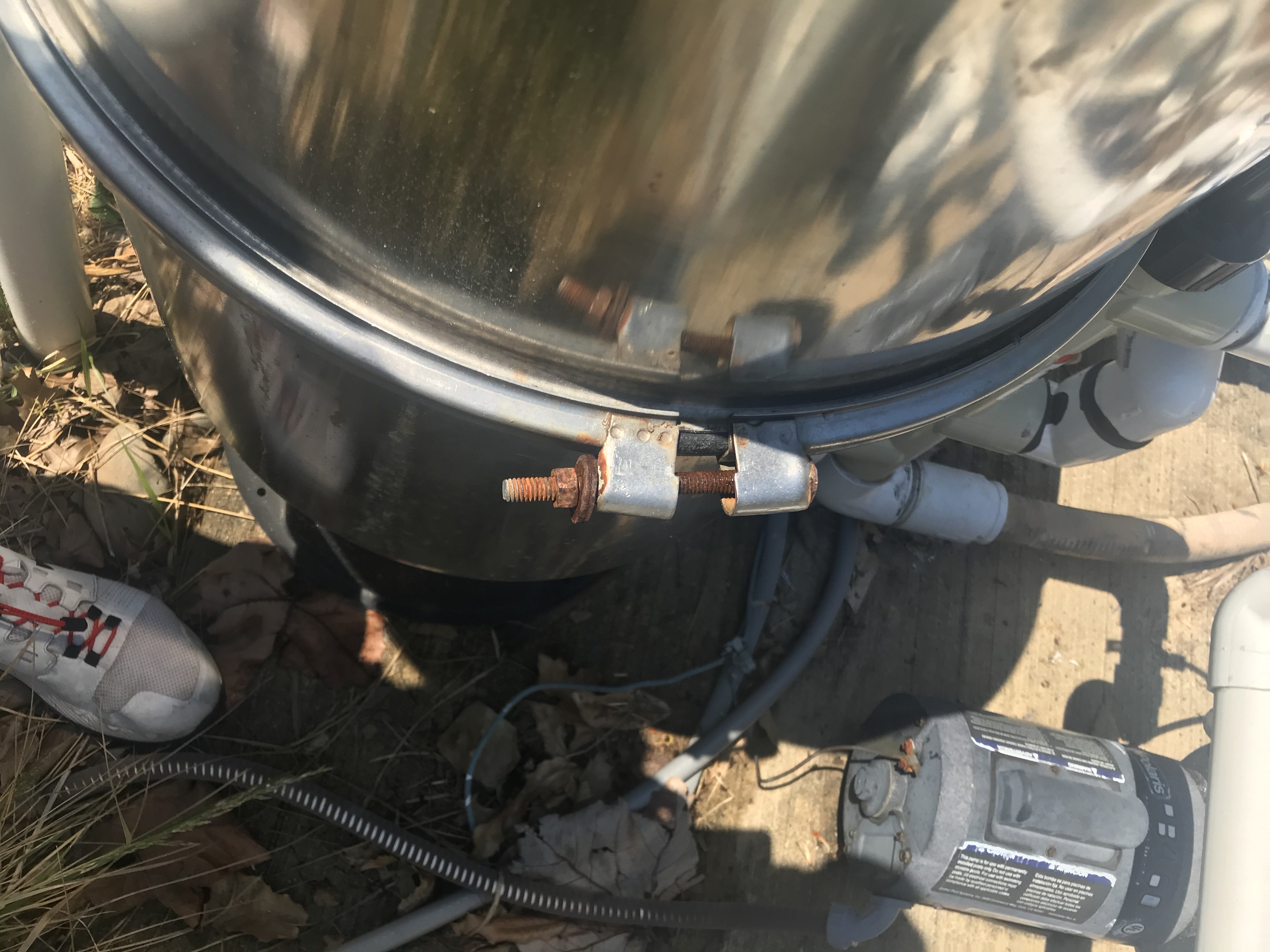

Attempting to open the pool the first time by myself this year. I think I've got everything working so far except for 1 major problem. I have a old (likely extremely old) Nautilus Stainless Steel DE Filter and I can't get the clamps around the middle of the filter right. Water starts shooting everywhere out of the middle of the filter when I turn it on. I can't get the clamps sealed right around the middle of the canister.
The clamps connect on both sides. One bold is rusty and I'm guessing hasn't moved in forever (Pic 1). The other side is some kind of T-bolt with like a brass sleeve nut (Pic 2). (I assume this is not some kind of original part and the pool guy just gave me whatever he happened to have on his truck last year when opening.) There was a spring (Pic 3) involved somewhere on the T-bolt/sleeve (Pic 2). I tried putting it in the middle but in the made problem even worse.
Any suggestions? Am I missing something completely obvious here? Or do I just try my best to tighten the living heck out of both sides of the clamp?

@RobHudson DANGER!!
There are two washers, one on either side of the spring... the tension is correct when the spring coils just touch. Too loose can be VERY dangerous, because 20psi of pressure is enough to eject the top with TREMENDOUS force. It can be deadly. I HIGHLY suggest you either replace the filter or buy new clamp hardware and a new o-ring gasket from inyopools.com.
PLEASE turn off your pump IMMEDIATELY before that fails catastrophically and injures you or others!

It's possible that someone Jerry-Rigged it and that the original clamp looks different. As long as the width of the ridge and circumference are correct for your model, it should work. Mine actually is spring-loaded on BOTH sides of the clamp, so yours probably was also at one time. :unsure:
Like I said before, I would NEVER run that thing under pressure without the correct clamp properly installed on it. This is nothing to fool with, it's just too dangerous. I only take my filter down for cleaning about once per year, and after I put it together I stand WELL clear when I turn the pump on for the first time even though I KNOW that I have it on correctly and have done it several times. I also take a photo before removing it and compare it with that photo when putting things back together just to be certain I have gotten it right.

Got the new clamp and I'm back in business. One question on air pressure at start up. What's the correct way to set the air pressure relief valve? I'm reading correctly, I start the pump with it closed. After the pump has primed, open the valve till water comes out (which means air has been let out), and then close. Turn off the pump and repeat until water is the only thing that comes out.
Do I have this correct?

You don't turn off pump... just open valve until only water comes out, then close it. Take note of pressure now. When it rises 25% from this point, time to backwash and replace 80% of DE.
