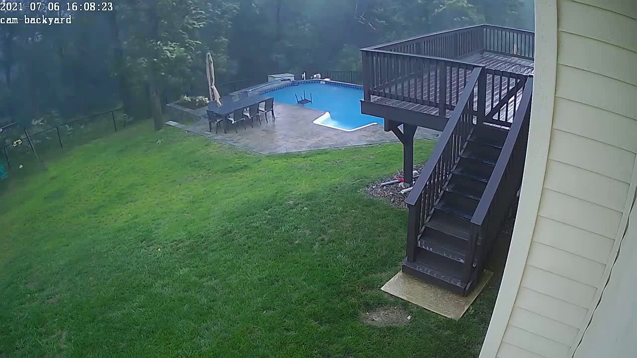

These snaps from my security camera were taken less than 12 hours apart. On Saturday morning we were in the pool for about 3 hours and the water was perfect. I happened to test it in the morning and my pH was a little high (I'm fighting with high TA) so I added my weekly dose of MA after we were done swimming. The chemistry was perfect otherwise.
On Saturday evening we had a rain storm of biblical proportions. The pool overflowed and there was probably a lot of runoff from the yard/patio that went into the water. On Sunday morning, I woke up to this green/brown swamp.
I immediately went up to SLAM level and I'm going to attempt to stay there until the water is clear again. It's a little tricky because my CYA is already at 60+, but I used liquid to start and I think I can use my SWG to maintain SLAM-level FC. My question though: am I just looking at dirt here which was washed into the pool by the storm? Or is it possible for algae to have grown in this short a time? Is a SLAM the right course of action?

Thanks, that's a good point. I seem to have a pretty effective schedule, for non-stormy days. The pump runs at 1725 rpm (about 30 gpm) from 8am-2pm and the SWG runs for those same hours. Then it runs at 1100 rpm (a little under 20 gpm) for the rest of the time, 24/7. This keeps the surface completely clean and it's basically zero maintenance. I guess I've been lucky up until now that any storm runoff is heavy enough to sink to the bottom, where the robot can scoop it up easily. We've had a few bad storms this summer and one other overflow, but it didn't affect the water like this.
One key difference I think: the power went out briefly during this storm, and after it came back on, I didn't check to see that the pump came back on. It should have resumed its normal schedule but I didn't check until the following morning. If it didn't resume the scheduled program for whatever reason, that definitely could have had an impact. Also for the future, maybe I'll bump the speed up proactively if I know there's a storm coming.
I'm running now at 2100 rpm (a little over 40 gpm) which was the speed I used for my initial post-construction cleanout. I've been down this road before, so I'll just keep slamming, brushing, vacuuming, and pumping until it's back to normal!
PS: this was a fun storm a couple of weeks ago:
but the water stayed clear. We didn't lose power that time though which means the pump never stopped. That could definitely have been the difference here.
