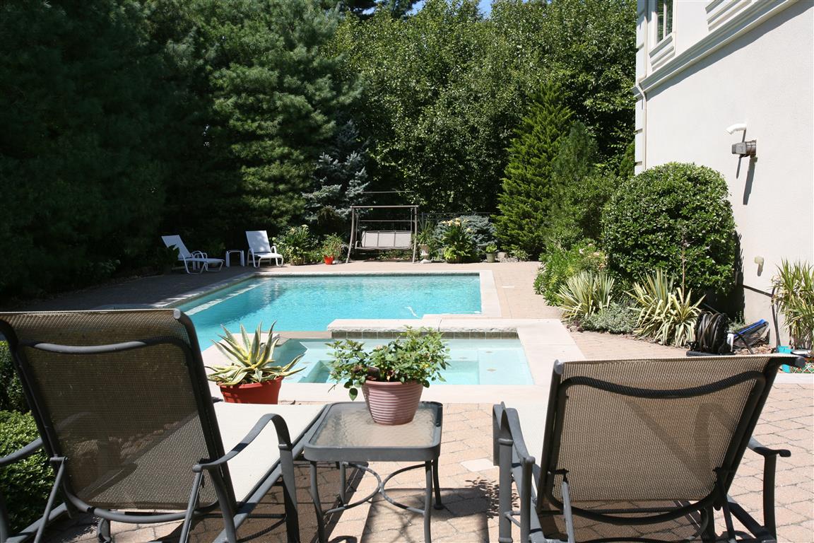

I would recommend going with a 2 inch thick travertine bullnose coping for your pool. Travertine holds up very well in a salt pool environment (I have travertine deck). If you like the white look of Lueders, you can get travertine in very light colors.

Aj, I’m looking to do a travertine deck also. Can you post pics of yours?
