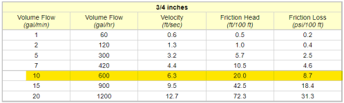

10 gpm through 100 feet of 3/4" garden hose creates 20 feet of head loss.
So, the flow would be about 9 gallons a minute through 100 feet of 3/4" garden hose if the elevation of the far end of the garden hose is the same as the pump end.
