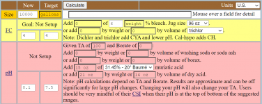

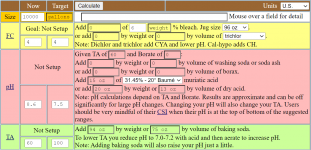

Look up the acid demand in the chart and then use pool math to see how much the pH would drop.
For example, if the Taylor book said that you need 15 oz acid, you know the starting pH was 8.1.
You can use either section, but the top section is more accurate.
Using the bottom section, you get a starting pH of 7.86.

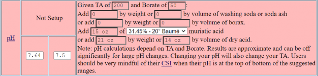

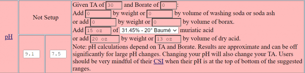

For example, if the acid demand chart said that it would take 15 oz acid to lower the pH to 7.5, the starting pH could be estimated to be at 8.1 if the TA was 100 or 8.6 if the TA was 60.
