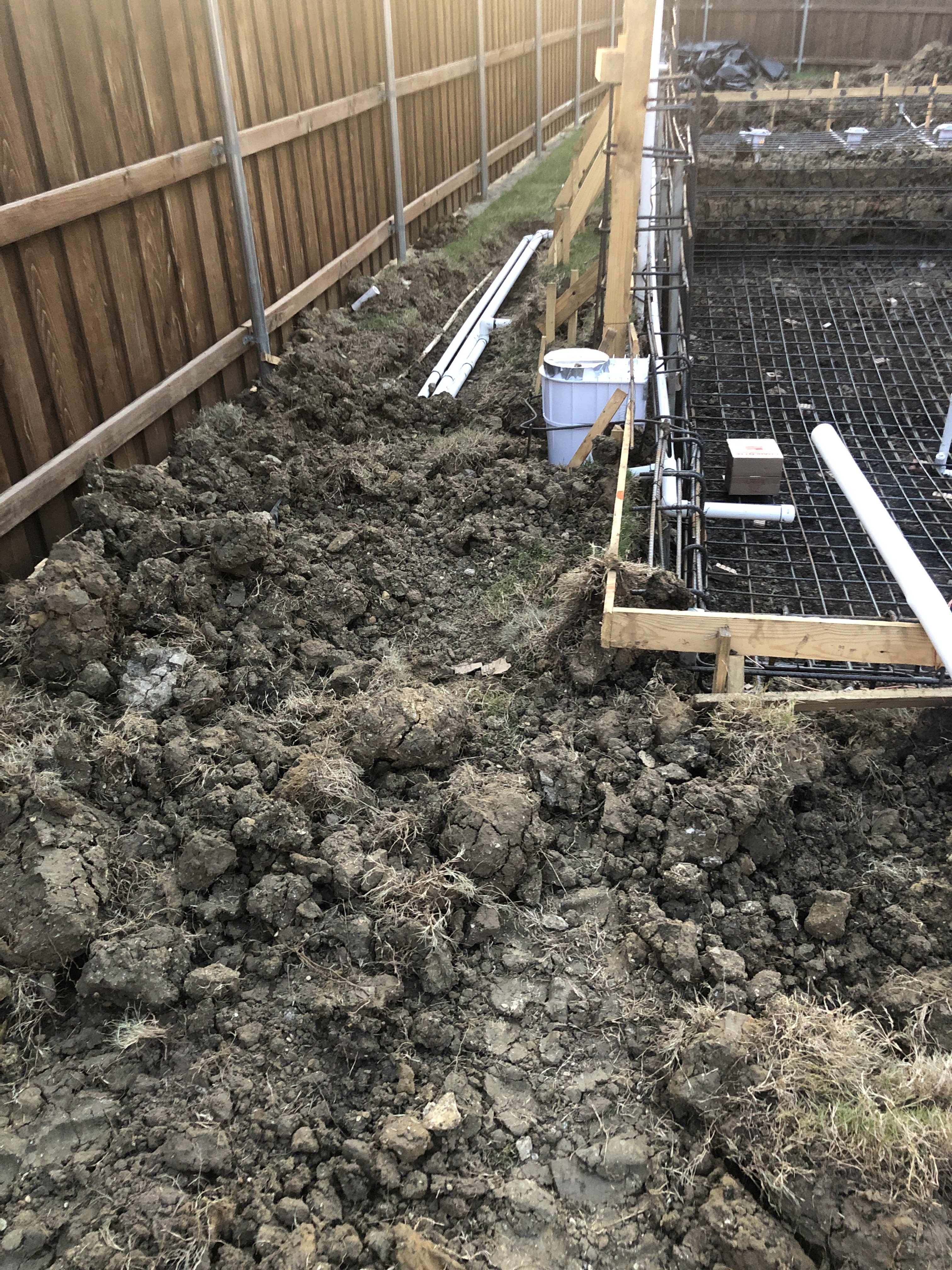

Doing BYOP. Done with excavation, rebar, plumbing. 2 Questions though. The plumber dug these trenches for the PVC but then didn't back fill it. we are planning to do pavers, who is supposed to backfill the yard to prepare it for decking? Do I do that after gunite (hopefully this weekend) and electrician are done with their stuff? Is that something I call the excavation company back for?
Also when the plumber was making the trenches, he knocked out a few of the pool beams, like behind the skimmer in the pic below. Is that going to be a problem for gunite? do I need to have the plumber come back and fix it or is that pretty normal?
Also, with all the plumbing sticking out into the pool, who actually cuts everything off and levels it, installs the fittings etc. Is that the plaster company?
Sorry, sitting here trying to figure out what sub contractors I still need to finish the job. Pics below

I did the same BYOP, have you passed the pre gunite inspection yet. I wouldn't bury the pipes until after they passed a pressure test, in case you need to fix them. There appear to be lots of dirt left on the site to bury them. The pool outline lumber will be fixed prior to gunite by the gunite guys. They will probably add pieces of plywood to the back to form the various bond beams and elevation changes. It's very stressful at this stage. don't be afraid to ask questions and take a lot of pictures along the way. Don't pay the subs the complete amount until the job is completely finished to your satisfaction.
Now is the time to go thru your engineering plans and plumbing plans to ensure everything is where it's supposed to be. The inspectors don't double-check all the time if all the rebar is where it's supposed to be. Mine just looked to see if the bonding wire was attached properly and placed in the right spots. My contractor forgot to put all the rebar required per plans at my skimmer box. Check the little details. as an Owner builder/it's your job to double-check the work and make sure it's done right or as good as it's going to get.
If all the rebar is tied off and the plumbing is done. Then call for pre gunite. They check for water pressure in pipes and the pool structure itself. all of the extra pipes are cut and trimmed by the plaster company as they are doing the plaster. I hope this helps
