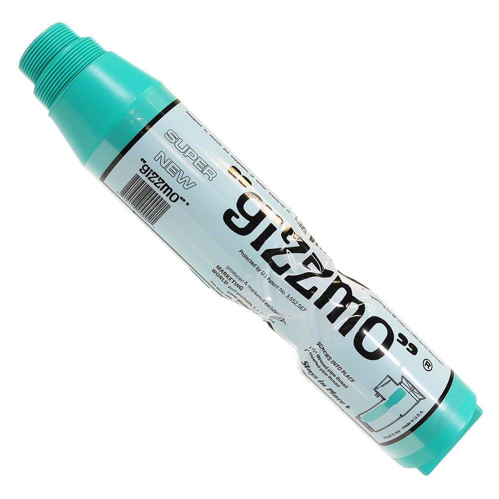

so I just read to get a tennis ball or something to block the skimmer before opening the pump.
Check your skimmer for threads at the pipe opening. If you have them, buy a winterizing ‘gizmo’ that us northern folks use to seal off the pipe. Usually this is the kinda thing I recommend getting from the pool store because they are so cheap, a $3 markup doesn’t matter if you can get the right one today, but they probably don’t have them by you so check Amazon etc. There are only a few sizes so it’s easy enough to get the right one if you measure what you have.
Rubber plugs work great too available at all hardware stores / home centers, but being much smaller, good luck finding it when you haven’t needed it in 9 months. :ROFLMAO:
