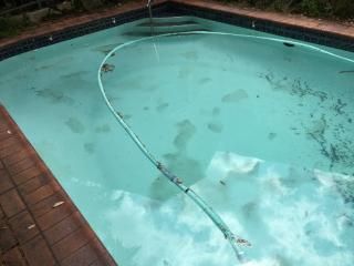

Black (I think?) Algae that will not go away - any help appreciated!
Hi all,
Great resource here helping each other - have often read it but only posting now.
I have a major problem I'd be most grateful for any help with. This pool was one my late father built (structural engineer), so it has extra special meaning to me. Its a 9,200 gal / 35,000 L, SWG, concrete/plaster (marblesheen is the term here in Australia), sand filter.
From last year/season and continuing now, I've had an endless problem with what looks like black algae (but its not limited to just small spots, and keeps reappearing in these patches that easily brush away but reappear within 1-2 days and get darker). I've been to my local pool shop and spent hundreds of dollars on their 'recommendations' - everything from copper based algaecide, multiple phosphate starvers, pool clarifier, tried bombing it with liquid chlorine to a high level (15+) also tried cal hypo bombing, kept pH lower around 7.0 to help fight the algae also. The copper algaecide helped only SLIGHTLY, but still, almost every day or two I'd be going and brushing the algae away but it just continued to reappear. Even with the chlorine very high, it still reappears and seems resistant to it. During last season I've tested the water weekly and everything has been within proper levels (CYA about 60, chlorine always at least 6-8, alkalinity always around 100 +/- 5-10.). Currently there is no copper algaecide left in the pool just for reference, CYA is about 40. Pics are taken all recently (last few weeks).
A few observations I've noticed:
- the level of calcium (CH) in the pool has repeatedly been 350+ in every test. I know concrete/marblesheen pools need higher calcium so haven't worried about it. The SWG often gets calcium deposits on the plates (less when I turned it slightly down over winter). In just a few spots in the pool, there is like calcium buildup (a slightly mound) and sometimes the black algae/patches will appear near these. Probably only 2-3 of these lumps though.
- there is two small spots in the deepend that look like actual black spot algae. I've bought triclor pucks and will brush them using a wire brush while leaving a puck on each spot for 30mins-1 hour this weekend. Nowhere else are there actual tight small black spots.
- on the outer edge of the pool, the black algae patches quite often appear in areas where the pool surface looks rougher. However, also is areas perfectly smooth it also appears sometimes darker (see pics).
- the shallow end pool steps have a metal handrail, and one of the bolts is slightly rusting (small patch of rust around it thats underwater). I mention this in case it has some relevance.
Please see the pics (ignore the few leaves near the pressure relief below to help identify it. I'd be most grateful for any help or guidance here - if anyone can work out what it is, its you guys vs the pool shop, clearly they have not been able to solve the problem at all. Thanks so much, Andrew.

Re: Black (I think?) Algae that will not go away - any help appreciated!
It does not sound like black algae, if you can brush it away......
Some/most of it looks organic to me.
Have you tested for copper?
How does the pool look now? Do you have/can you take a pic of it just after vacc'ing?
Please post a current set of test results:

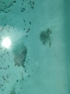

Re how it looks, see the pics below with explanations -
1) This shows the algae towards the middle of the pool. That darker smaller stuff as well as the lighter, wider patches. Both just brush away fairly cleanly, and also vacuum up no problems. Usually this smaller black algae is concentrated towards the middle and deep end, the wide type (see bottom left of pic) is all over the pool.
2) Example of the lighter, wider spots. These are usually a bit darker than the pic looks, but not as heavy dense dark as the stuff at the top.
3) Another close up of the patches - this one is towards the outside of the pool, and seems to be on an area where the plaster is a little rough (a few spots are like that).
4 and 5) These are the only two actual black spot algae in the pool - they won't go away or change by brushing the area. Notice the area of darker patch around them? thats very similar if not the same as the other wider patches mentioned. Could these two spots be somehow distributing the other algae that brushes away around the pool?
6) Another example of the dark patch of algae that bruses away cleanly.
7) How the section in 1) looks after vacuuming - i.e. algae completely gone with pretty much nothing left behind.
Sorry this is so long. Really appreciate everyones help. I'm just lost as to what to do having tried almost everything.

You have a basic misunderstanding of chlorine. It kills algae....period. If what you have there is algae, chlorine will kill it.
My suggestion would be to read the ABC's of pool water chemistry in Pool School to get a better understanding of how your pool is reacting.
Then, clean your pool thoroughly and SLAM it.
You mention vacuuming but it does not appear pool has been vacuumed in some time......am i missing something?

Hi, yes I know and this is what has been so puzzling. I've literally kept chlorine above 15 for a 2 week period last season (first with liquid chlorine and then cal hypo) and it made only marginal difference. The algae would still reappear within two days. Also for probably 2/3 of last season the FC level was 8 - same story.
Re vacuuming, see the last pic - I deliberately waited till after testing to take a before/after shot. Last season I tried brushing the algae almost every day (no exaggeration), it would always brush away very easily but be back the next day or second day without fail.
That's why I've posted on this forum, as the pool shop here & people I've spoken to have not been helpful at all.
Could the algae have built up resistance to the chlorine?

Just for reference, this is how the pool looks only 2 days after completely vacc'ing it (and it being perfectly clear after it) - the algae is darker and worse than what appears in the pic:

I've never seen black algae, so will not venture any opinions on identification of what is shown in your photos.
However, reading through this thread, it strikes me that the unsightly phenomenon in the pool is stated to be algae, even though it hasn't really been identified as algae. The fact that it doesn't seem to respond to high chlorine levels would probably argue against it being algae.
Have you tried 'capturing' some of the stuff in a container? Maybe see if it continues to grow? See how it reacts to chemicals added to the water? Perhaps look at it under a microscope (if you or someone you know has access to a microscope)? Rub it between your fingers to see what it feels like?
Just saying -- you've already put a LOT of time and effort into fighting this stuff; maybe it's worth putting some effort into direct identification.
