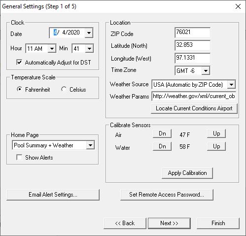

I have the following page in ScreenLogic..
It shows the local weather across the bottom.. For some reason, it no longer updates.. I tried to update the set up page below, but can't get it to find the local airport.
It won't let me enter anything..
I am just looking to see if it is just me, or if something has changed for everyone??
On the set up page does your system allow you to enter or pick a State? Mine won't anymore.

Something I just noticed, in your screenlogic pic it states
Code:
http://weather.gov
, the link I provided states
Code:
https://w1.weather.gov
. Websites change all the time. Maybe if you change the beginning of that link in the weather params of the screenlogic general settings everything will sync up again?
Just a thought.

I tried both the old http and the new https://W1. and it made no difference..
I did not try http://W1.. ??
The real problem for me is that it used to allow you to enter your State and then it would find the Internet address.. Now it won't even let me enter a State.
Your link let me manually set up the address, but neither the old way or the new way worked for me. ☹
