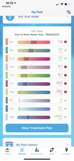

These are the results as of yesterday. I have added acid and PH levels are good and in range as of total using the water test kit.

These are the results as of yesterday. I have added acid and PH levels are good and in range as of total using the water test kit. I M new to all of this so I dont understand a lot of the chemicals and or pool stuff. I am learning

There is lots of help on the forum so just ask if you do not understand. This process can help you kill all the algae and have a crystal clear pool at half the cost that pool store will want to sell you stuff.
First, this appears to be test results from a pool store. Pool store testing is highly unreliable and it is suggested you do your own testing if you really want to take control. The pool store is crazy for telling you a FC of 6ppm is too high when we are in the middle of summer and UV constantly eats away at your FC level. You do not need to buy anything to lower your FC, it will decline simply due to sunshine. Furthermore, pool stores want to test your water because they can sell you unneeded items. Please review Test Kits Compared and purchase your test kit.
If your test results could be believed then a CYA of 50 requires a FC level of 6 to 8ppm. So you are not high but on the low end and in the summer it is always best to error on the high side of the range. In TFP we follow a simply chart which was given earlier but here is again. FC/CYA Levels. Look at your CYA level and then look at your target FC level. To avoid algae you need to stay in that range throughout the day or you risk having algae.
Don't worry about the phosphate and calcium levels at this time. That can be reviewed later.
I think you have a saltwater chlorine generator so you need to read the lower half of the chart. In fact, you should target to increase your CYA but lets get rid of algae first.
You need to purchase liquid chlorine and raise your FC level to 20ppm. This is part of our SLAM Process which you need to read and get familiar with. Once you start your SLAM, turn off your SWCG as you will be using liquid chlorine to raise and maintain your FC level to rid your pool of algae. Also, it is best you have your own test kit because you will need to test your water every 4 -5 hours during a SLAM (during day light hours).
