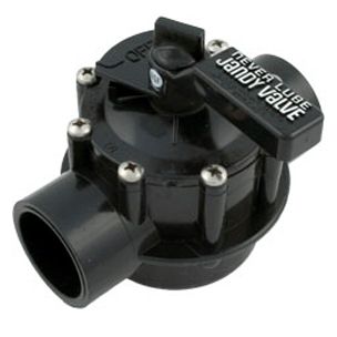

use Jandy neverlube valves 2 way on each suction and return side pipe (how many returns are you getting? 2?
use high temp unions on pump (these are 2 inch, make sure your pump can use the 2 inch...

It will cost extra to hard pipe everything. The installer I thought we were going to use recommended we start with the flex that come with the equipment (he said the Hayward ones are good quality) and convert to hard pipe later when we're sure of our setup. My husband is pretty handy with plumbing stuff, so I think we'll be able to hard pipe it ourselves later (he's currently more tied up than usual because he's taking classes, so this is all falling much more on me right now than I really expected).
